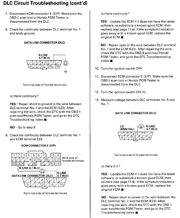

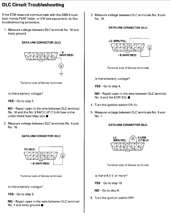

The battery is brand new and fully charged, in fact the car turns on, but wants to die as if the power is cutting off. and the RPM and Temp gauges are normal but the battery light stays on. After approximately 3 min of running the RPM and Temp Gauges die and the check engine light comes on and the car idles at a higher RPM than normal, but does not accelerate properly. I tried to connect a scanner to diagnose the problem, but it gives an error mess to check connection. No info. is obtain from the car to determine the problem. My car is a 2002 civic and does not have a distributor, it has crankshaft and camshaft sensors and four coils. Please advice...
Old Mar 13, 2009 | 08:56 PM
Your Civic may have multiple problems.
The battery light suggests an alternator problem. Start by cleaning and tightening the battery connections. Also check whether the alternator belt is loose or broken.
I am also concerned that, during installation of the timing belt, the cam and crank were not perfectly synchronized to TDC1. In addition, engine damage may have been sustained when the timing belt slipped. Have the cylinder compressions been measured since the timing belt slipped?
You also have an electrical problem that is preventing retrieval of CEL codes. See diagrams below for troubleshooting.
