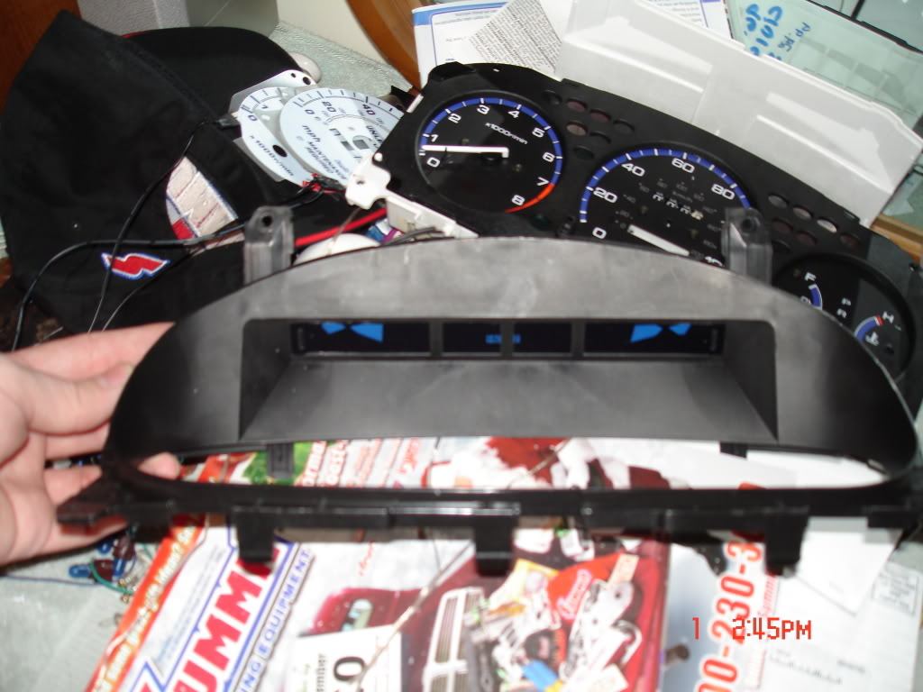

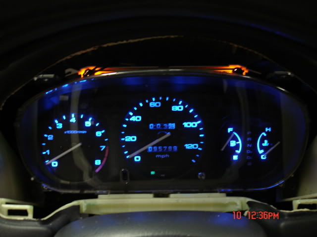

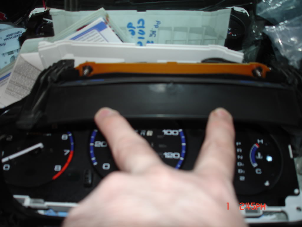

Old Jun 17, 2007 | 01:38 PM
Default RE: Instrument panel guages
BUT they suck.... stock cluster is VERY DIM!!!!!
do a cluster led mod
my cluster mod DIY
https://www.hondacivicforum.com/m_433337/tm.htm
beats the HELL OUTTA STOCK GAUGES!!!!!!!
SO IN SHORT THE NEEDLES DONT LITE UP
Old Jun 17, 2007 | 01:43 PM
ej6buddy's Avatar
Posts: 5,794
yay for your pictures, i hate explaining things like this

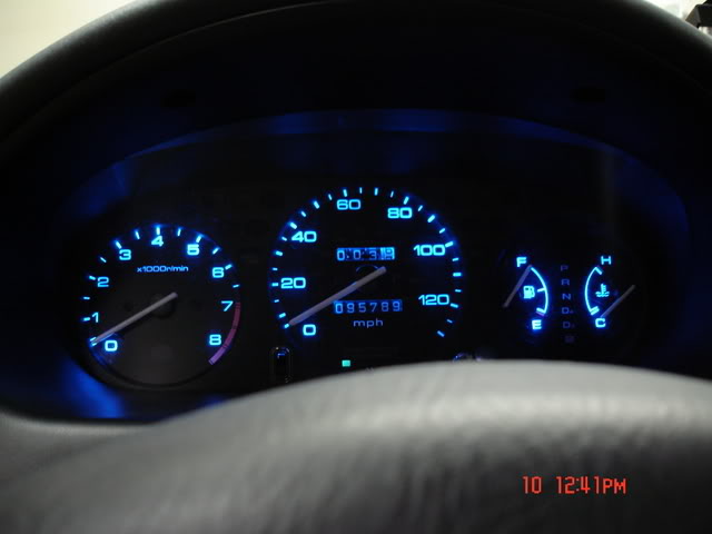

Old Jun 17, 2007 | 02:12 PM
FlipHKD720's Avatar
Posts: 8,442
From: Marquette, MI
^ thanks for that addiction, i took that strip out and never really understood what it did
but +1 for those custom LED gauges, i did mine like that and they are AMAZING! How mine turned out:
Old Jun 17, 2007 | 04:10 PM
ya i left my 2 lights stock it helps lighting up the needles ALITTLE... tho they are still pathetic.... BUT the blue compensates
