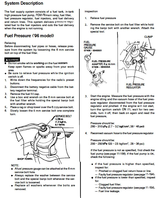

If the timing and timing belt are fine, then check the fuel pressure. You might have a faulty fuel pump or pressure regulator.

How do I safely check for a vacuum leak. I've heard of using starter fluid spray and other flammable aerosols that would cause the engine to increase the idle rpms when it was sprayed on or near the leak. That isn't very safe. The other option would be to have a smoke machine check it I guess. I have tried very very soapy water and looked for bubbles but I did not find any leaks.
What is the best way to check the pressure regulator given that I have just the Joe Public tools.
