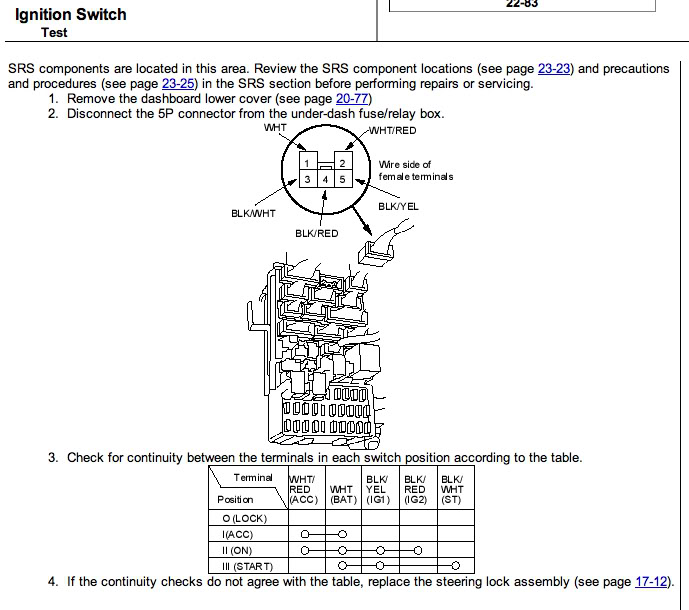

Old Apr 20, 2009 | 09:10 AM
Originally Posted by laack
Anything that I can do myself, or am I better off bringing it to the shop?
You can test it:
