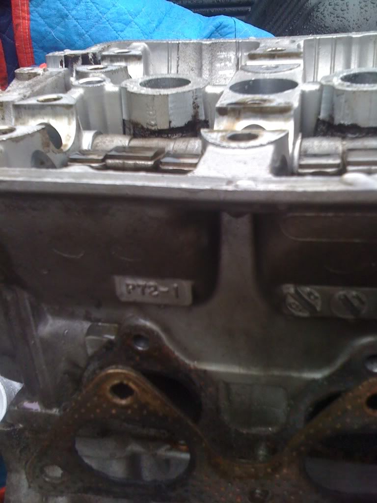

The adventure continues...I need to know how to go about identifying the head that this dude put on the d15b block before selling it to me. I have noticed that the oil cap is located in the front left of the head- which i have not seen before. Am i losing it guys? I am getting kind of in the weeds with this- all i need to know is what i am working with so i can figure out what to do next. I have the d15b block- that is confirmed. Now i need to know what head i have- any tips in identification would be helpful...Thank you- Jordan
Old Jan 24, 2011 | 08:13 PM

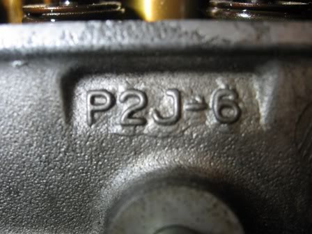

Look here and post me what it says on head just above exhaust manifold

Old Jan 25, 2011 | 06:16 PM
small.usmc's Avatar
Joined: Jan 2011
Posts: 11
94civichatch- thanks for your input man. I am learning as i go with a lot of help from you guys... I downloaded the honda repair manual and i have been snatching all the diagrams and info i can. Ok- checked the head stamp and it says PM8-4. PM8-4. Checked the code on it and it says it should be d15b8- but it is a 16 valve...on the bright side- i took the cover off today and it looks gooooood. Like brand new man. I got a photo on my cell, can put it on facebook but tougher here. Anyway, i have decided to go honda parts once i nail this down (nobody else makes good direct fit- there are like 4 different manifold/cat converter combos for this year) and take it to honda for a full tune. Then i can work body and suspension slow and save money for a d16z6 head and all the gear to go with it. As long as this jdm d15b and usdm d15b8? combo runs good (fingers crossed- still hoping for someone to tell me it is doable and should be problem free to run it this way) i should be able to smog and then i have a dependable car i can work on over time, which is exactly what i want. Talk about an emotional roller coaster man- just want this to work

Also- compared my pics to head diagram in repair manual- most closely matches d15b7. Same questions apply- ok to run this head/block combo?
Old Jan 25, 2011 | 06:26 PM
91 civic DX D15b2 ---------------PM8
your fine, its just a ""performance" head.
