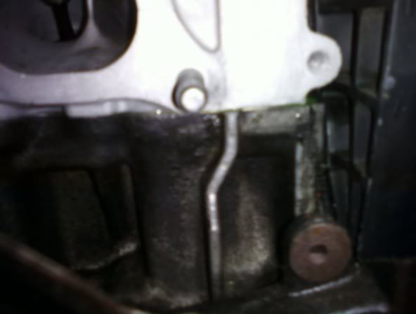

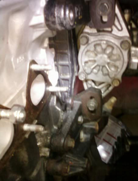

i havent started the car yet.. the leak seems to be only after it cranks.. i think im gonna tq the bolts down to 75 ft lbs.. since thats the max that arp recomends.. they are at 65 right now

did u tq the bolts in the correct order? looks like somethings not sitting right with the gasket. either a crack, bent, or the surfaces' aren't right. def bad if its leaking with no pressure. if u have access to a cooling system pressure tester you could try that and see what happens, tho i'm sure it'll just squirt coolant as soon as it gets pressure..

it does appear to have a small gap between block and head around that area.. i havent measured it.. theres a dowel right in that area and yes i tqed them down right.. i had the manual right there.. and took pictures in order that i tqed them so i could do a how to...
This information together with the coolant leak at this location is more than enough reason to pull the head off and inspect the mating surfaces of the leaking area.
