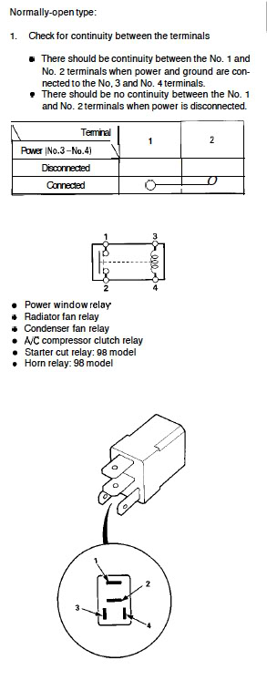

You were right about the condenser fan! I unplugged the connector and ran it with my dewalt 12v battery (after measured no current upon switching) and the a/c stopped clicking and the inside cooled down (artic)! Is this a simple fix? What would the cause of this be? Its gotta be as simple as something as a switch right? Im going to go to autozone and try out a new relay, just in case that doesnt work any ideas?

how do I test the relay, I have voltmeter.

RonJ thank you sooooooooooooooooooooooooooooooooooooooooooooooooo ooooooooooooooooooooooooooooooooooooooooooooooooo much for your help on this issue. I found the problem, it was my condenser ground. IT WASNT EVEN BOLTED ON! My car is right in front of me now purring and popping like it should and the interior of my car couldnt be colder! Me and my little girl both thank you for your help on this! I am becoming more amazed by this site every single day!
