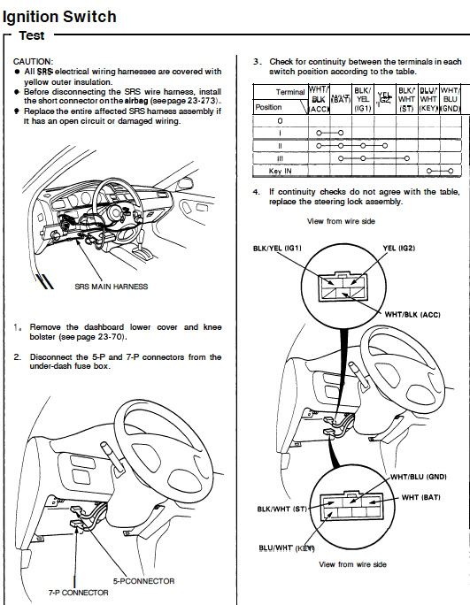

Old Dec 22, 2008 | 09:15 PM
Is there battery power at the distributor connector? If so, check the igniter unit in the distributor.
Also double check all of the engine ground wires and then test the ignition switch:
