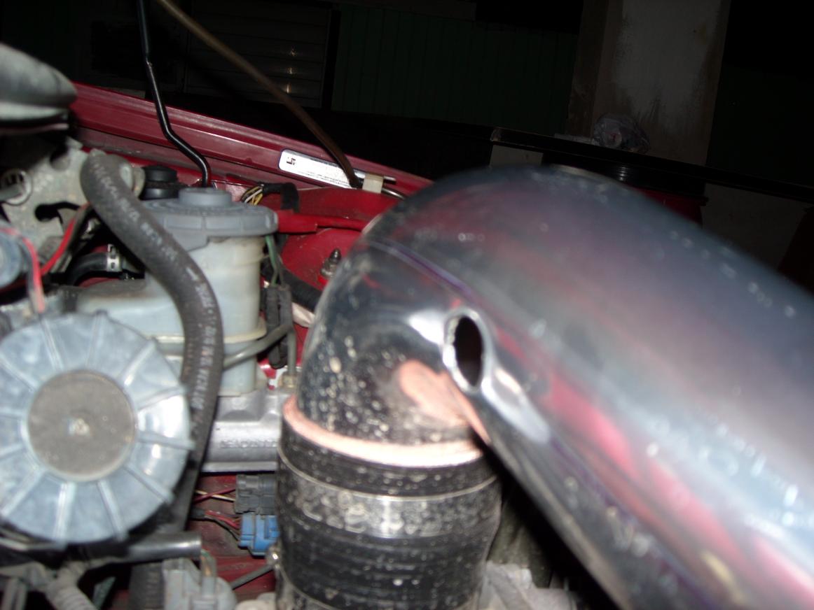

Old Sep 29, 2008 | 07:19 PM

this is a picture of the hole i found

Old Sep 29, 2008 | 07:32 PM
That hole may be where the intake air temperature (IAT) sensor should plug into. Would the hole let unfiltered air enter the throttle body? Is the CEL ON?

Old Sep 29, 2008 | 07:50 PM
Look between the firewall and throttle body for a loose connector attached to the wire harness. It used to plug into the right side (standing in front of engine) of the stock air filter box.
