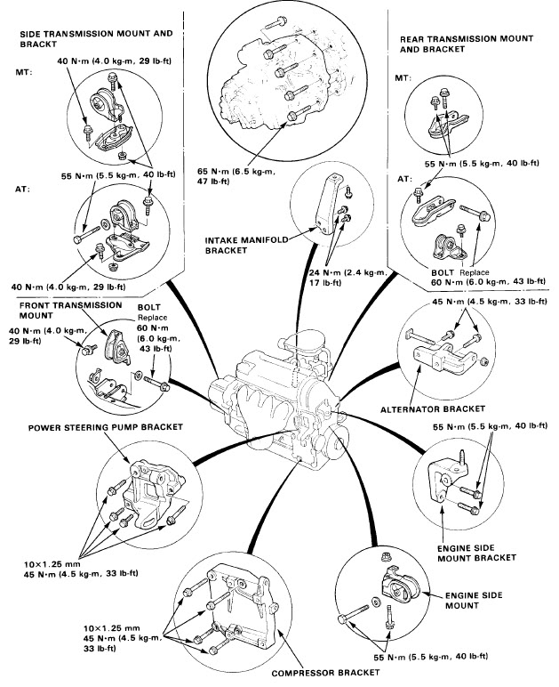

ok i have a 91 civic hatch it has a d15b7 motor and an 88 crx trans i changed all the mounts in the motor and trans but yet i still fell a jerking movment in teh car from when i get on and off the gas can anyone help me please!!!!!!
Old May 18, 2009 | 01:04 PM
Did you replace all of these mounts and tighten them properly? The rear mount is particularly important for the movement you describe.

theres only 4 mounts on the hole thing 3 on the trans and one on the motor i replaced the the 3 on the trans i just checked to make shure there all tight and there are could it be ANYTHING ealse ?
Old May 18, 2009 | 01:31 PM
How does the engine mount that you did not replace look?

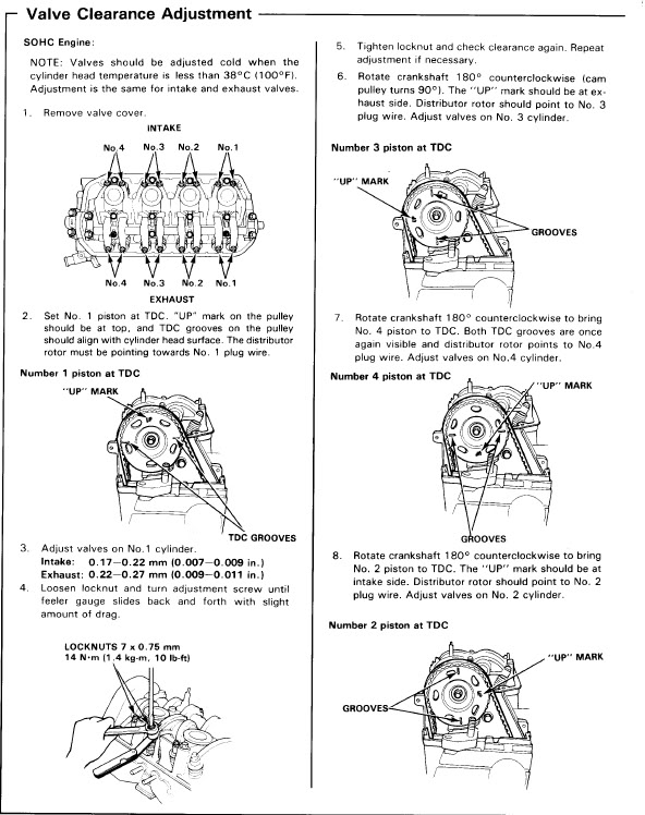

thanls ill check em all out also do u no how hard it is to do the valve adjustment ?
Old May 18, 2009 | 02:04 PM
Originally Posted by justin07731
...also do u no how hard it is to do the valve adjustment ?
