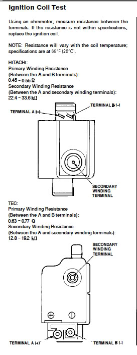

Old Nov 10, 2008 | 06:09 PM
Is the CEL ON?
If there is power at the distributor connector, here's how to test the coil:

yes the cell is on, i have no clue if its for more than just this but its been on because i dont have a secondary oxygen sensor hooked up (i cant get the plug out of the body) and the diagram would be very helpful if i had a meter :s
