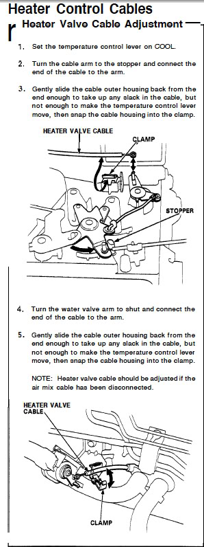

The upper illustration is for the heater cable mechanism behind the dash and the lower one is for the heater cable valve mechanism on the firewall in the engine bay. The diagram will help you determine whether the mechanisms are broken. Regardless, you should be able to close the heater valve on the firewall if it is open. This way heat won't continue to blow from the vents as the weather gets hotter.

Usually you only need to adjust the cable at the valve (which is mounted on the firewall, on the engine side) to fix this. This is the second half of the instructions Ron posted. As a final check, make sure that you cannot move the valve arm further by hand when the lever is on cold.

Ok, I followed it outside the firewall and found the heater valve. I put the lever all the way on cold and couldn't move the valve anymore by hand. But, I took off the heater valve cable and could move it a lot more. I don't have time to look at it today so I can't figure out why the cable doesn't want to push the valve closed. Anyone have any ideas why this is? I figure the cable isn't positioned right but I can't find where I could adjust it.

Unclip the outer housing of the cable and move it toward the valve lever, then reattach the clip. If it won't move that way you'll have to go under the dash (refer to the first picture) and adjust the other end of the cable housing, in the other direction.
