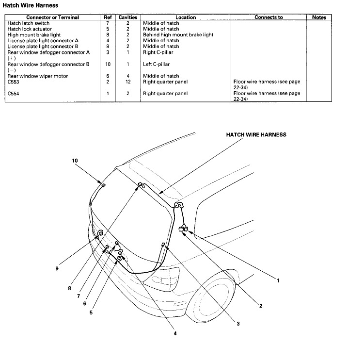

Edit: All those components may be on a single wire harness. Check whether the main connector for the wire harness is damaged or disconnected. What you are looking for are connectors like C553 and C554 in the diagram below.
