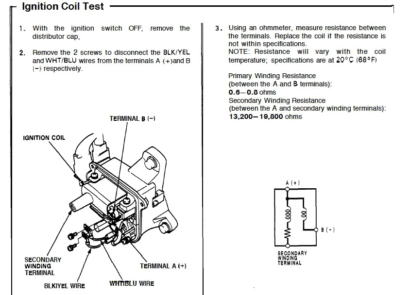

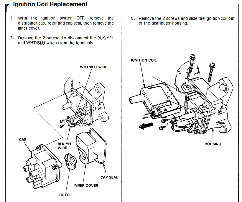

Do you hear the fuel pump prime for 2 seconds when the key is turned to ON(II)?
Check whether the timing belt snapped by removing the oil filler cap and looking for whether the camshaft fails to turn when a buddy cranks the engine.
Check whether the BLK/YEL wire of distributor connector has battery power when the key is turned to ON(II).
Here's how to check and replace the coil in the distributor:
