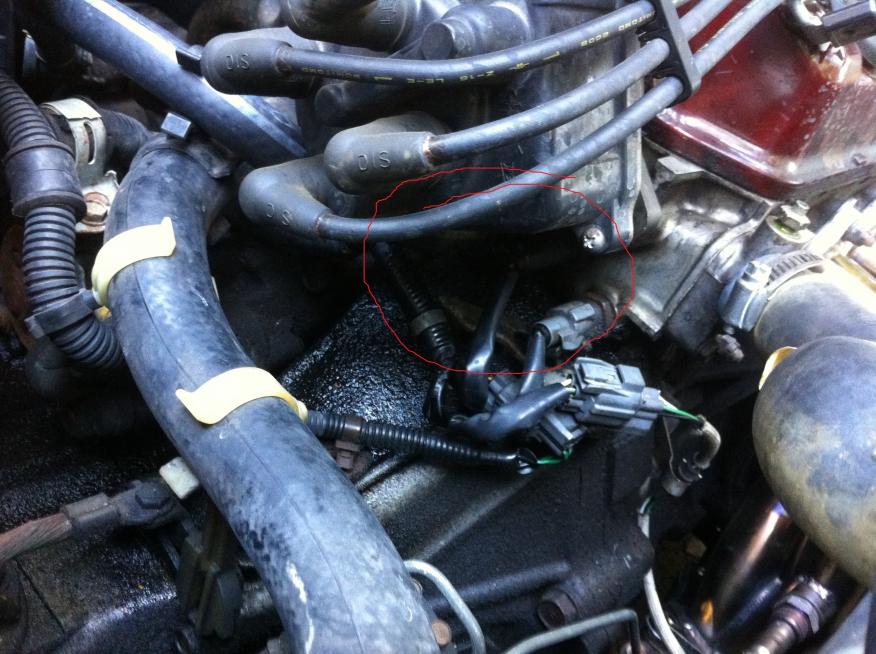

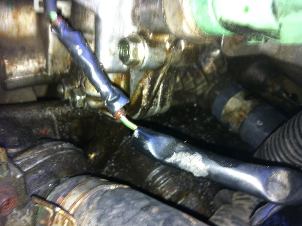

I have a 94' honda civic ex 1.6L vtec.. every 4-5 days i would have to fill my reservoir (coolant) to the max line and add some to the radiator. Also every week or so add a quart of oil. I bought this car about 7 months ago for pretty cheap because it needed a head. On the left side of the engine bay i see wetness coming from the beneath the distributor area/ under vtec controller. So heres what ive done so far: replaced oil pan gasket, vtec controller gasket, distributor o ring, and replaced the heater core hose that runs from beneath the distributor from the side of the head because i noticed swelling just behind the clamp. Well now its been a week and a half i added maybe a quarter quart of oil, and refilled the reservoir up and radiator once again. Also heres a note: when it gets nice and warm and i go to a redlight it wants to idle so low it almost stalls or if i go inside a store and come back out and start it it stutters a few seconds then clears. Any other suggestions?

Default another picture
heres the above picture where its coming form.

My guess is the head or head gasket are your problem for both problems. Most engines don't idle very well with coolant in a cylinder.

As for the oil leak, it looks like it may be coming from the VTEC controller area. You mentioned already replacing the VTEC controller gasket, which I assume you replaced the larger (about 4" long) gasket on the backside.
Did you also change the camshaft solenoid gasket? It's the smaller, roundish (about 1" long) gasket located between the VTEC controller and the cam solenoid. If you remove the three bolts holding the cam solenoid to the VTEC control assembly, that's where you'll find the cam solenoid gasket. It's a pretty common cause of oil leaks in that area, besides the main VTEC gasket.
Another thought is the internal distributor shaft seal. You mentioned changing the (external) o-ring ... did you by chance check out the internal seal too? Those tend to leak after so many years. Especially in cases where the engine has overheated, most all rubber gaskets and seals will have a tendency to be weakened from the excessive heat, and start to develop leaks.
Finally, as other posters mentioned, the head gasket sounds like a possible culprit as for the coolant loss problem.
Good luck!
