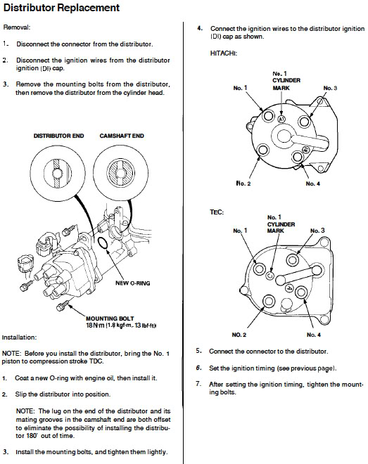

How much oil is inside the distributor and where i it located? I would try to use a solvent that leaves no residue.
The picture pertains to 96-98 Civics.
