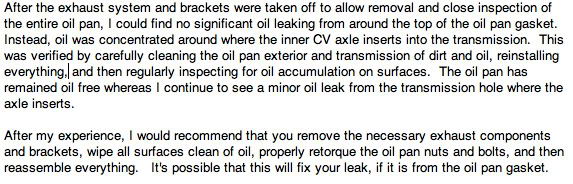

Default RE: Oil pan change:
I thought that I had a leak from the oil pan gasket, so I recently initiated the same job on my 97 DX 5-speed. In the end, it turned out that the leak was not coming from the oil pan gasket, but rather probably from a seal where the driver side axle inserts into the transmission. Anyway, I removed the relevant exhaust components mentioned by mk (pretty simple), as well as all the oil pan nuts and bolts. The difficulty came when I tried to remove the oil pan itself. It was firmly attached to the block! I tried some prying with a large flat head screwdriver without success, though I avoided applying too much force in fear of causing damage. As I eventually discovered the leak was not from the oil pan, I just slapped everything back together. I'd be interested to know whether you also encounter difficulties in removing the oil pan and how you eventually get it off without damage.

RonJ,
How did you know that it was not the oil pan leaking? My car has some oil residue around the pan but b/c of the horror stories of people not getting it off the block, i've been avoiding this repair.
Old Jun 6, 2008 | 09:44 AM
