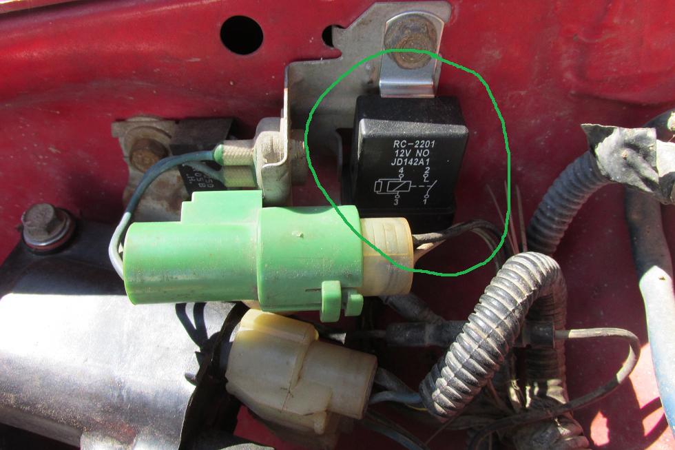

Here is the relay I was sold. i replaced it and nothing changed.

The carb ones have a really complicated system to adjust the idle mixture automatically using an O2 sensor, a small computer, and a whole ****load of vacuum-operated stuff. It is hard to keep working properly and most of the parts are now unobtanium. It works on the principle of causing a variable air leak into the carb to lean out the mixture. If you don't need to pass a smog test you may be able to bypass it so it just runs rich all the time.
Like any other carburetor car you need to make sure the automatic choke is working.
Fuel delivery is IIRC completely mechanical using a camshaft-driven fuel pump. You can see if there is gas in the carb through a window on the side. There is no main relay like the injected models have.
