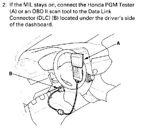

Maybe this diagram for 01-05 Civics will help:

that's right. most of the plugs are right under the steering wheel

I think federal law requires all OBDII plugs to be in about the same place, under the edge of the dashboard on the driver's side, so they're easy to find.
