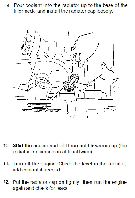

Maybe Im just not seeing it then, I do appologize. But all I see in that section is how and where the drain plugs are for the block and radiator, how to check the cap, and ect switch and then to refill. It does say to bleed the system but for some reason I cant find it in that chapter
Old Jul 20, 2009 | 11:52 AM
You'll find it in the Refilling and Bleeding subsection.
Park the car on an inclined driveway with the front higher than the rear and turn the heater ****/lever to MAX heat.
Then follow steps 9-12 precisely:
