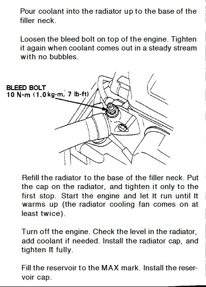

When you replace the IACV, you must top off the coolant in the radiator and then bleed the cooling system.
1) Park the car on an inclined driveway with the front end higher than the rear.
2) Push the dash heater lever/**** to MAX heat.
3) Follow the directions in the diagram below (ignore the bleed bolt step as your engine does not have one):
