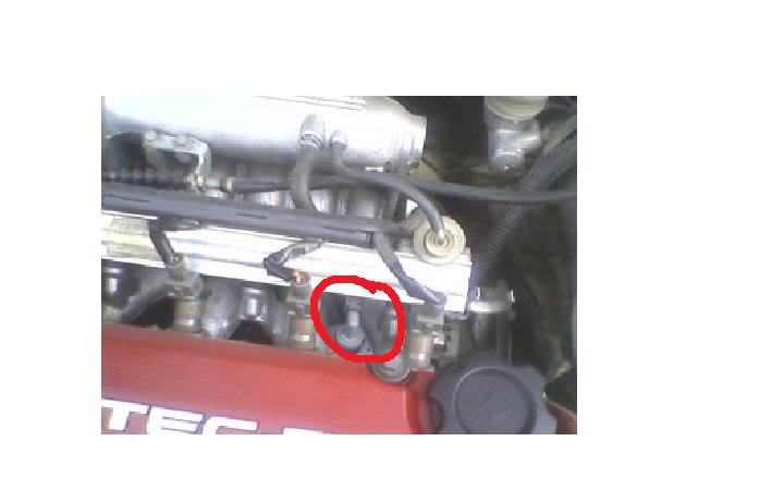

i need help loacating the pcv valve on a 1995 civic.
Old Aug 30, 2009 | 02:46 PM
its on the intake manifold just behind the fuel rail. it has a vacum line goin from the intake manifold to it.

thanks man , but i dont think i have the same engine. i have a lx. i don't have the vtec.
Old Aug 30, 2009 | 07:59 PM
its still there thats a non vtec stock dx/lx intake manifold.

thanks, do i need to get under the car to get to it.
Old Aug 31, 2009 | 08:34 AM
no just pull it up. it will pop right out. and then take a pair of pliers and take off the vacum hose. its a 2 min job
