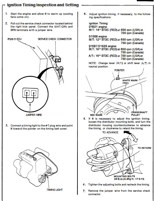

Ok I understand everything else when it comes to the timing light BUT I don't understand step 4. It's saying "RED" needs to be at a certain degree...do they mean the red mark on the Crankshaft? Because I know there's a group of 3 marks(the middle one is red) on the crankshaft..then there's the mark thatss kinda separate that you have to align with the pointer on the oil pump(or bottom timing belt cover).

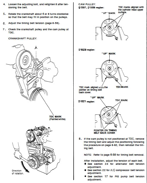

Ok hold on...after further observation of the instructions in this thread it saids i have to have the WHITE mark aligned with the pointer when putting in the timing belt...BUT when I get to the Ignition Timing part it says I have to have the RED mark aligned with the pointer.......Now I'm really confused.
You do the ignition timing with the engine running. The timing light has a strobe effect which will make it look like the pulley is sitting still. The red mark (center of the group of 3) should be under the pointer.

It happens. After you reinstall the timing belt with the cam and crank at TDC1, rotate the crank 3-4 revolutions only COUNTERCLOCKWISE to verify that the mechanical timing remains dead on. If so, install the lower timing belt cover and tension the belt. Then you should be good to go.
