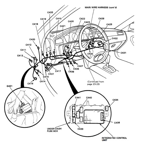

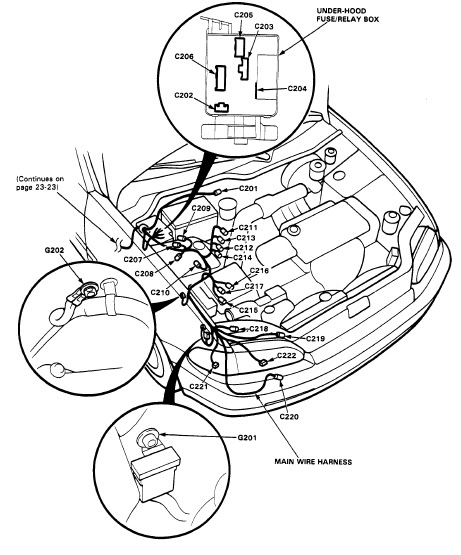

Check the G201 and G401 ground wires:

where is the g401 i cant tell where that is exactly
Old Jan 17, 2011 | 04:04 AM
mk378's Avatar
Posts: 10,023
The picture shows it on the side of the car under the dash. My '95 also had a ground wire right behind (in front of) the cluster. Whenever seemingly unrelated electrical stuff interacts, suspect a bad ground. It could also be that your tachometer unit is just bad. Sometimes they can be fixed by resoldering the circuit board inside, like a main relay.
