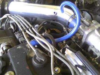

Ok after 36 views maybe some people don't know what I'm talking about so here's a couple of pics of the remaining connection hole on the Short Ram tube..LOL.
If nothing belongs to that connection hole & it's left uncovered..will it interfere with the airflow that's already being sucked in by the filter?

Just cap the hole. That is for 96-00 Civics which have the Air Intake temperature sensor in the intake tube rather than in the intake manifold (like the 92-95 Civic have).
You can get a soft plastic cap at your local hardware store. I think it would be called a vacuum cap.
I assume that is an eBay intake system? If so, I can guarantee that is what the hole is for. Also, if it is an eBay system, throw that filter out and buy a better one such as an AEM dryflow filter.
