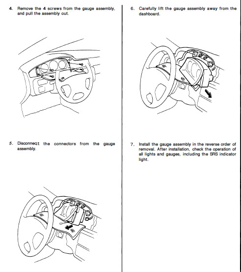

Ok yeah I wasnt really planning on buying that one I was just mainly concerned if I bought one with a rpm tach if it would work so this answer is yes correct?
How hard is it to put one in and anyway I can adjust the mileage? (want to make it what mine is currently) or is that a big no no?

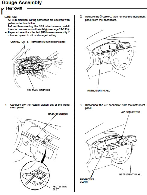

The easiest way to keep the miles the same is to take the speedometer / odometer unit out of your cluster and put it into the new one. They need to be the same color and style for that to look right of course.
