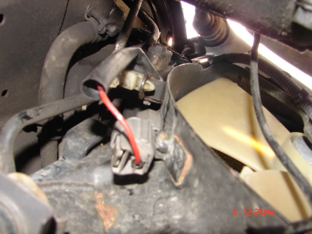

iight mk378. i got under the car and looked where you said and found this...
is this the harness you were talking about. its the only one that i found. it has the red wire going in and then nothing else coming out. and does the black wire go on top of the harness.thanks for the help btw.
Old Jun 4, 2009 | 09:15 AM
mk378's Avatar
Posts: 10,023
Yes, that is it. Plug the wire from the compressor into that empty socket with the red wire.
The other wire (black) from the compressor coil should be grounded to the compressor frame. A stock compressor has only one wire leaving it, a red one.

ok i was alittle confused...because the wire i was looking at was black. but its a sleeve type of deal and the wire under was red. so i put it in that socket on top...as for the shield thing...i took it off and didnt notice any damage. maybe its over charged. how much would a ac place charge me to un charge it and then recharge it. or should i have them first check if there is a leak somewhere.
