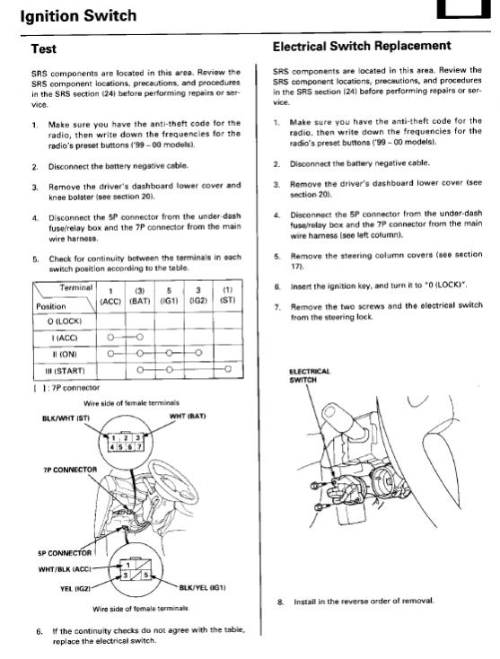

Test the ignition switch in the ON(III) position.

Got it all taken apart, have no idea which connectors the 5P and 7P ones are. I cant figure it out by the wires going in out either. Any more detail as to which plugs im after?
Old Oct 25, 2013 | 11:46 AM
See step 4 in diagram.
Also, 5P and 7P refer to number of pins/slots in connector.

Well I found the 5P connector, redish/brown color coming at the top of the fuse box. I cannot for the life of me figure out where that 7P connector is hiding. I I see 4,6,8 and more but no 7's in that pattern.
Any ideas? Maybe im just looking the the wrong spot? Should be right near that box someplace right?
Old Oct 25, 2013 | 12:04 PM
Left side of steering column.

Ok. Pretty sure I found it. Its tucked away up above the fuse box, behind the metal support that the plastic trim parts attach into.
Also, not 100% confident on how to check the continuity. Put the red prong on the 7P Battery wire and then one by one check the 5P, record #s and report back? Correct?
Old Oct 25, 2013 | 12:26 PM
There are three separate pairwise continuity tests for the ON(III) position:
(3) - 5
(3) - (1)
5 - (1)
