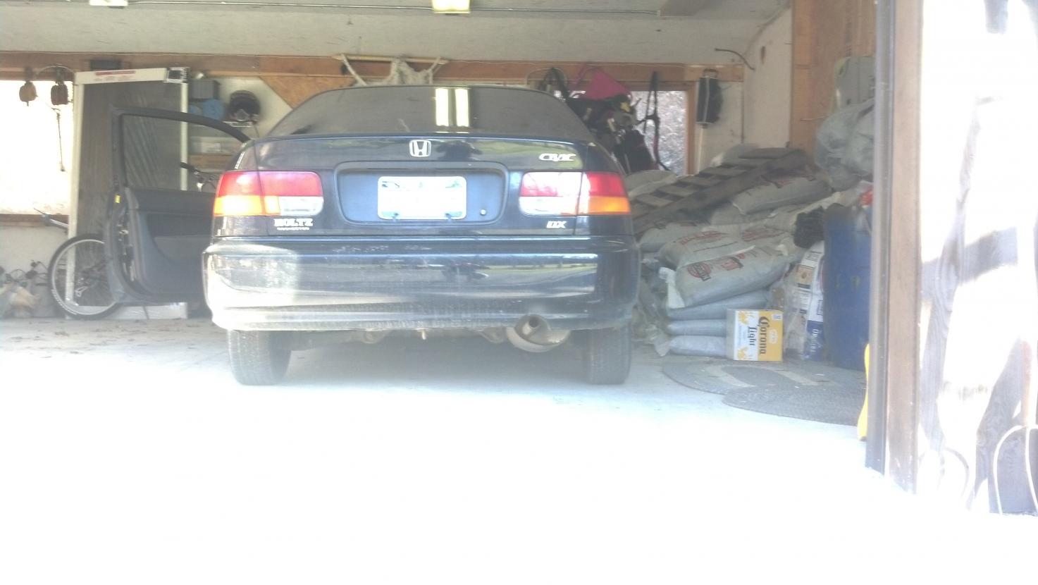

Old Dec 19, 2012 | 10:18 AM
firecatf7333's Avatar
Joined: Nov 2008
Posts: 68
Default pic
pic of tires

Can someone offer help here? I push down on my trunk and the car will bounce right back up. Something isn't right, b/c the back tires wear bad on inside. I can stand back and see how the tires kick out slightly.
Old Jan 14, 2013 | 12:30 PM
Bouncing right back up is one thing, but does the car continue to bounce without you pushing on it afterwards? It should just come straight up and basically stop.
I cannot think of any other explaination as to why you would be rubbing when you have a full car except for struts.
Wear on the inside of the tire is associated with camber. When is the last time you had an alignment? When is the last time a mechanic did work to the rear suspension and what was done?

could this be from bad trailing arm bushings?
Old Jan 21, 2013 | 08:52 AM
civicexracer's Avatar
Posts: 5,802
Sounds like you probably have some bad bushings. I'd start looking at the trailing arm bushings first. When they wear, crack, tear, they can cause some serious control issues with the car. Check all the other bushings while you're at it. Bad bushings, esp a trailing arm bushing, can throw your alignment off causing the instability issues as well as the tire wear.
