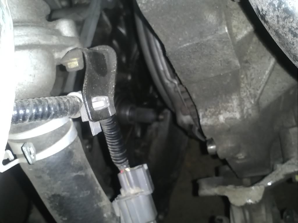

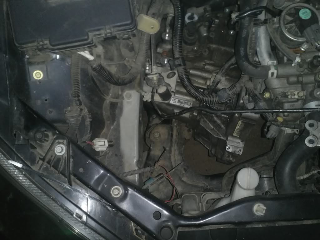

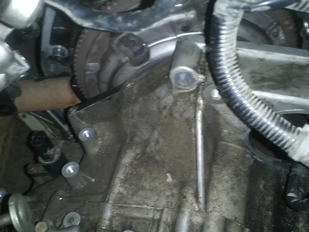

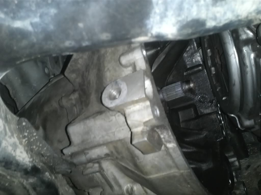

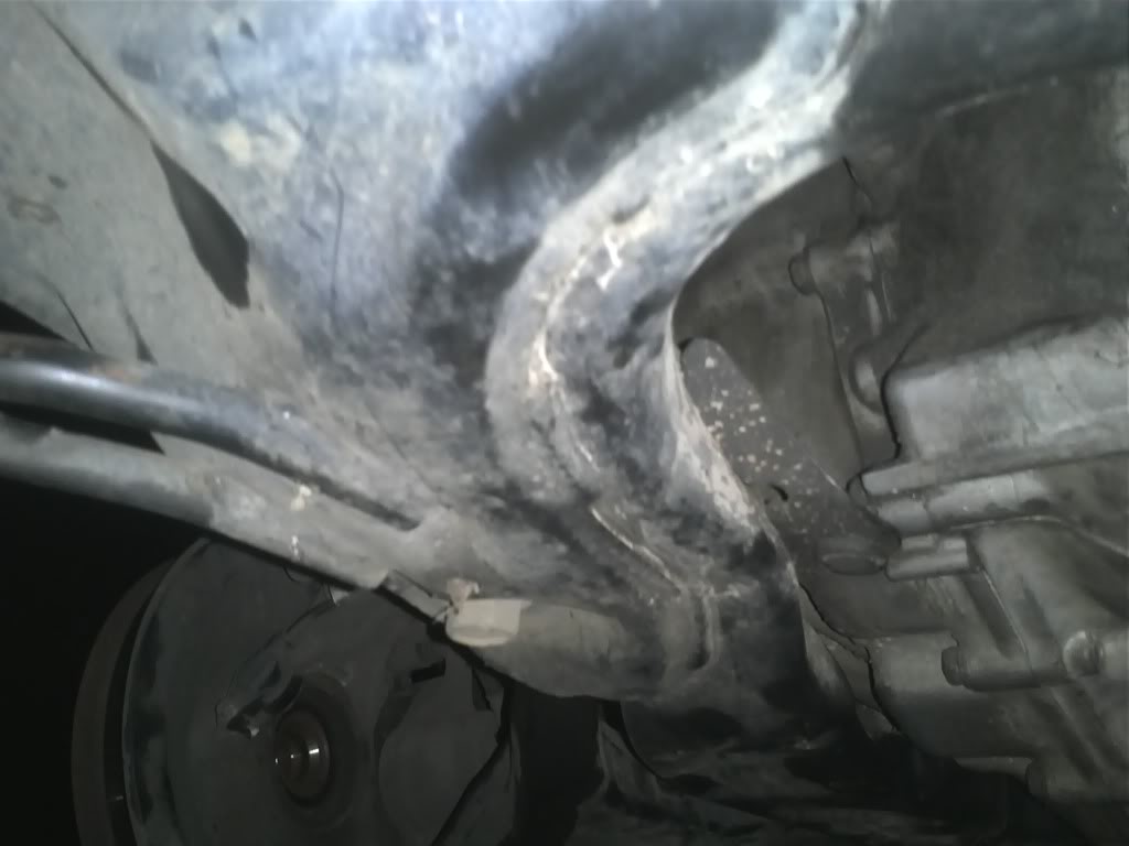

I'm still stuck, getting an engine lift in the morning to try and see if that helps. I just can't seem to find a way to get it out even with my friend helping me. I have thought about undoing the front center engine mount and lowering the passenger side of the engine down with the tranny back on and pulling it down under the frame if it will go down that far safely. Here is what it looks like right now.

Ok, got the transmission out finally! Had to drop the whole front subframe and the downpipe on the exhaust along with it. Now that I have replaced the input shaft bearing and put the tranny back together and have it back in the engine bay with the subframe bolted back up. But now I can't get the tranny bolted back up. Having problems get the shaft back in through the clutch plate and flywheel. Anyone have any ideas?

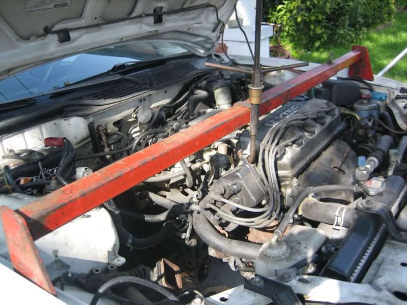

Turn the fly wheel a little so the mainshaft would fall into the grove, then you should be fine..
I use my engine hanger like mk said, big help
