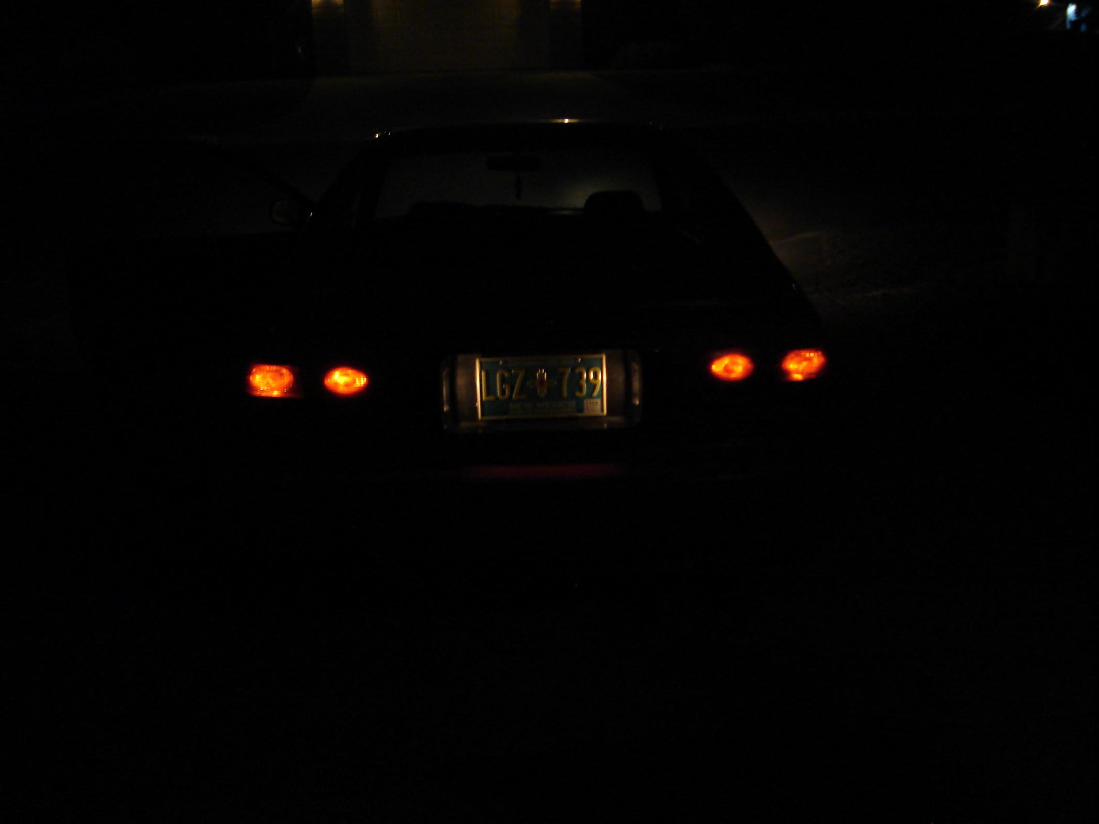

okay so my tail lights don't work. today went and got new bulbs/fuses i put em in however they still don't work. my blinkers and license plate light and running lights all work so whats the problem? here's a pic
Edit: -tail lights + Brake lights* lol
