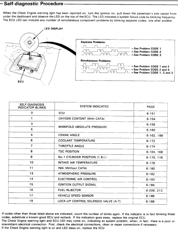

how do i read teh beeps and with key to on or car running ?
Old Jun 12, 2009 | 01:52 PM

ron i get a code of 1 and 10 how do i fix ?
Old Jun 12, 2009 | 02:19 PM
Code 1 = potential problem with O2 sensor or fuel pressure regulator
Code 10 = potential problem with intake air temperature sensor
1) Check whether the intake air temperature sensor is disconnected.
2) Remove the HAZARD fuse in the main fuse box for a few minutes and then reinsert. This will clear the codes from the ECU. Drive the car to see whether the CEL again turns on and whether the same CEL codes are blinking from the ECU. If so, this would warrant troubleshooting both codes.

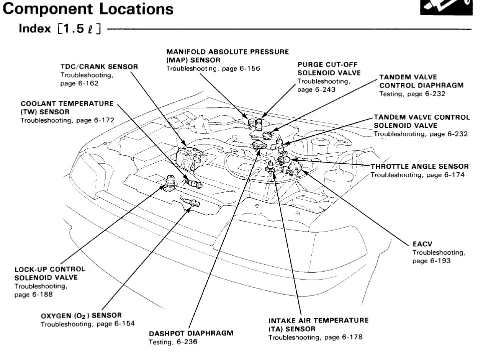

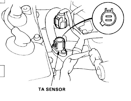

were is the air temp sensor located ?
Old Jun 12, 2009 | 02:29 PM
