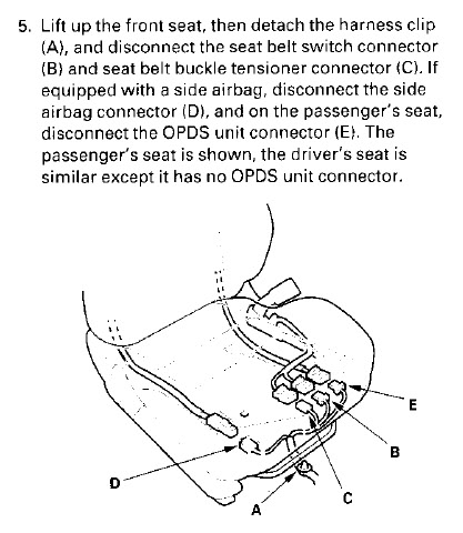

I tried relatching the seatbelt with both my Civic running and off, and that didn't work. I read another post about a wire being loose, so Ilooked atthe wires under the seatand they appear to be fine and securly attached. I didn't do too much surgery to look at the wires, just felt the wires as far as I could, and eyeballed them as much as I can. Its acting like my seatbelt isn't fastened even though it is.

Its probably the mechanism inside the buckle. I have the same problem on two different cars. I think awhile back that the manufacturer has to replace any malfuctioned seatbelts, you may want to call the dealer. If they say they don't, I would call American Honda for a replacement. Good Luck!

I'll check out the connectors this weekend. If they are ok, i'll probably just go VFR direct to Honda USA and see if they will replace it. Unfortunately, i've had bad experiences with the local Honda dealer's service department when they used to sell Infinity, and I won't go back there.
