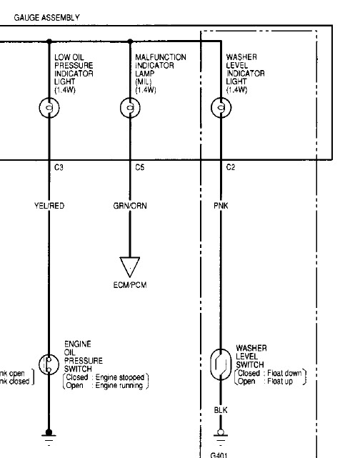

Old Jun 5, 2009 | 09:35 AM
Ill just pull out the cluster and take a look.
Good idea
If the bulb is fine, check the GRN/ORN wire at connector C (terminal C5) of the cluster and connector A of the ECU (terminal A18):

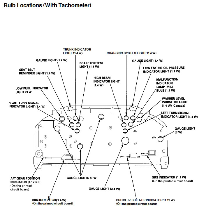

Old Jun 5, 2009 | 10:18 AM
This may also help:
