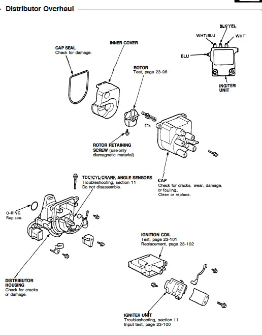

If the fuel pump properly primes even prior to a hard start, then I'd recommend that you next focus on the distributor. You might have a failing coil or igniter unit. Start by opening the distributor and carefully inspecting the coil and igniter unit for damage and the wire connections for corrosion or looseness. Also double check the contact points of the rotor and distributor cap while they are disassembled.

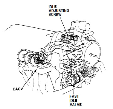

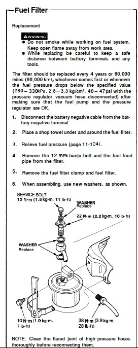

Additional thoughts:
If the distributor seems fine, then:
1) Replace the fuel filter ($20)
2) Clean the IACV/EACV on the throttle body (see forum DIY section).

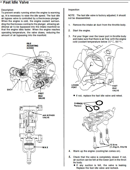

This sounds like hard starting specifically when the engine is cold, as I inquired about in my first post. Given the absence of CEL codes, first clean the Fast Idle Valve as you would the IACV.

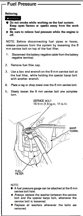

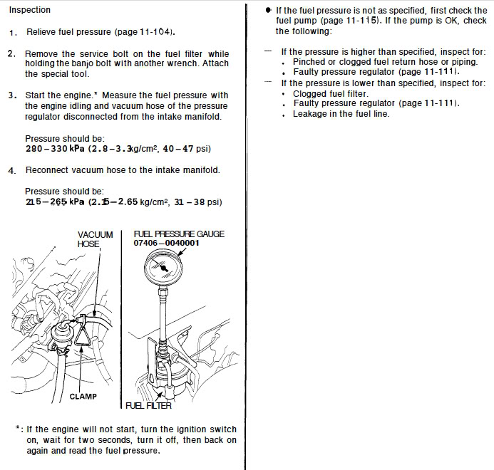

First make sure that the fuel pump always primes when you have the hard starting problem. Regardless, replace the fuel filter as it is cheap and easy. If that doesn't fix the problem, then measure the fuel pressure:
