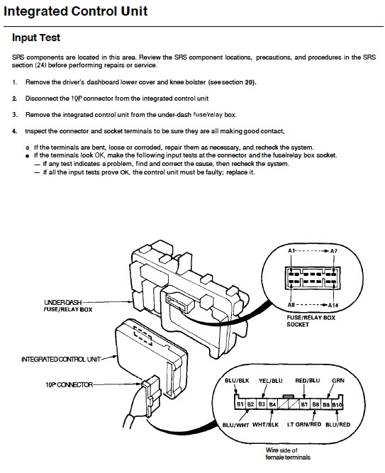

A common link to all of the problem functions is the Integrated Control Unit.

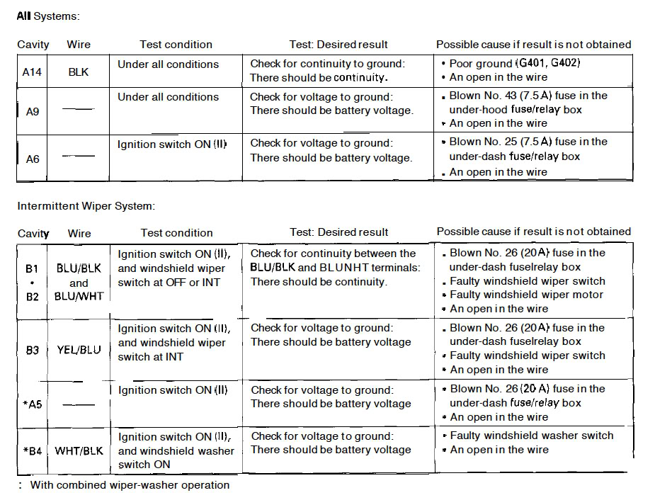

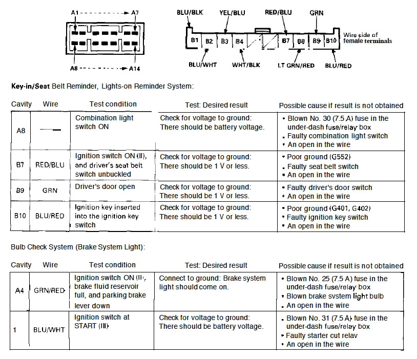

To see what shakes out, perform the electrical input tests in the diagrams below with the headlights ON versus OFF. Post results if you want feedback.

Excellent, thanks. The ICU is one thing that never popped up via a search no matter what site, or criteria I used. Will see what happens and post up results when I get a chance.

ICU checks out fine, the issue still persists. Without cracking open any of the loom on the harness the wires looked to be in good condition. One thing I did notice was one of the wires coming off the connector that goes into the ICU has a small brown connector on the end that doesn't attach to anything; I'm assuming this is just an obsolete wire that feeds some option I don't have on my DX?

If all the ICU input tests are fine with the headlights ON or OFF, then the ICU itself is probably bad. Another possibility is a faulty under-dash fuse/relay box.
