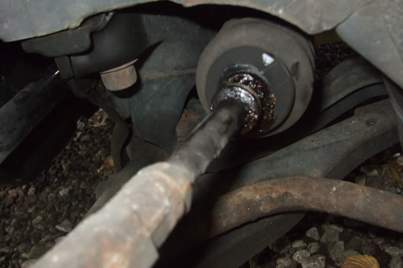

2000 civic LX 1.6L 5sp......I got this deep creaking noise when i turn the steering wheel...sounds like a old rusty door hinge off of a bank safe. I mean its pretty noticeable. I took a look at the suspension today will take a closer look tomorrow but....i did see both of my steering gear boots on the outter ends have separated from where they were clamped down...and grease is leaking out.
Right Side
Attachment 6660
Left Side
Attachment 6661
I am just surprised that both of them are like that. Do any of you think its too far gone just for a boot change? I assume a heavy grease goes inside of it like a CV joint?

Most of the time the creaking noise would cause by the outer tie rod, spay some grease in the outer tie rod boot if you can then test it.

after further investigating last night....here is what i found. I had my friend sit in the drivers seat and turn the steering wheel back and forth and it sounded like it was on the lower end of steering knuckle (driver side)...the only thing there is the outer tie rod and the lower ball joint....since i am changing the boots and will have tie rods off...they can be replaced at that time. Then there is only the lower ball joint left....which my luck that will be the prob. I have a whole A arm ball joint upper/lower kit i have had under the bed for about 3 years so i guess it may be time to install some of these items.

I highly recommend replacing those torn inner accordian boots that cover the inner tie rod. If you let it go too long the joints on the inner tie rod will go bad, and those are a pain to replace. The boots are only like $15 each.

Yeah i figured it out...i had some things worn out.....a tie rod end for one....steering rack was suspect also so i wound up changing that and that is what i am sure it was it doesn't make that noise anymore since i changed the steering rack. That was a pain in the ass but not as bad as i thought it would be.
