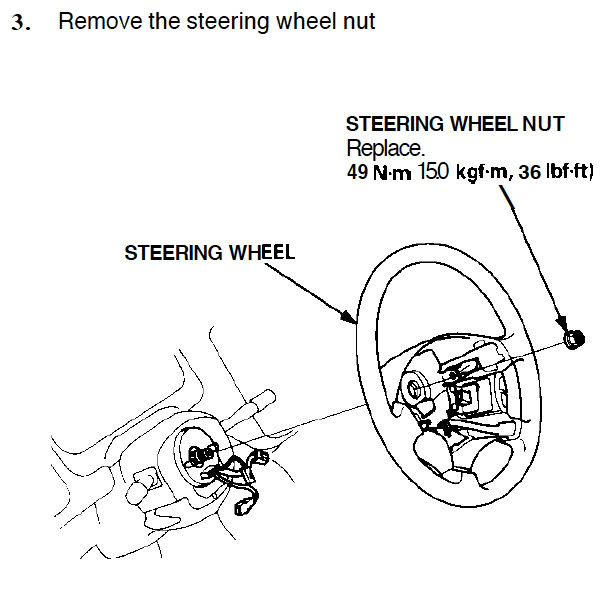

Old Jun 3, 2008 | 12:05 PM
Default RE: steering wheel,installation question. read.
Old Jun 3, 2008 | 12:20 PM
enigma34's Avatar
Posts: 892
From: griswold, ct
mmmm. thanks.i dont have a tool to tell my how tight its on.
