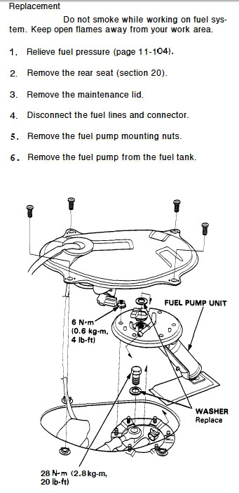

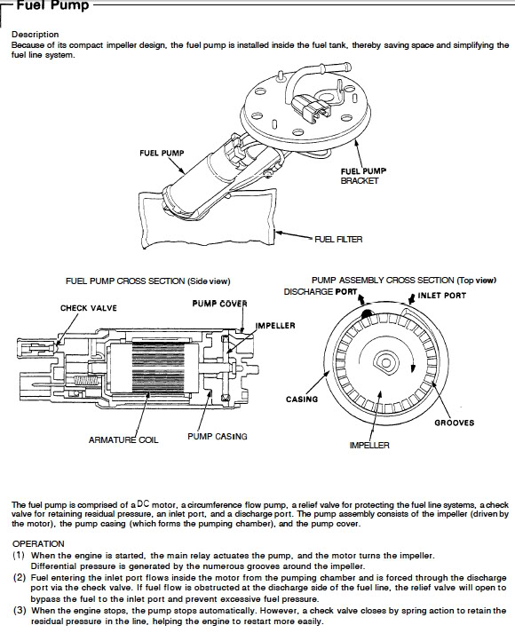

You can inspect the fuel pump in the gas tank (see diagrams).

It's easy to take the pump out and inspect it, the tank should be mostly empty first though. Have a new tank filter on hand and just install it whether it seems to need it or not.

Thanks for the pictures on the fuel pump, I appreciate the effort. I have found the online service manual but it is nice to know that I am looking at the same pump as you. Please keep all ideas/theories coming. I will replace the tank filter, after a thorough inspection, thanks for that tip.

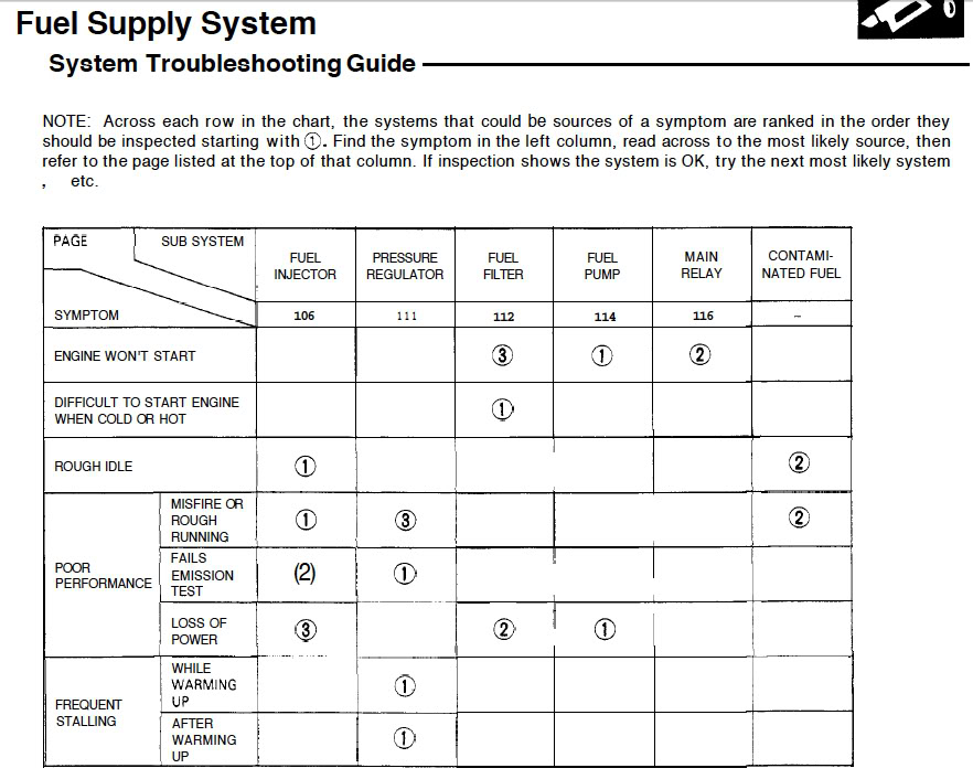

I understand your continued focus on the fuel system.
If you would characterize the problem as rough running/misfiring, then the Fuel System Troubleshooting Chart below suggests that you consider: (1) problems with the fuel injectors (Seafoam treatment?), (2) contaminated fuel in the tank (drain and discard remaining fuel when problem occurs at 1/4 tank?), and (3) problems with the fuel pressure regulator.
