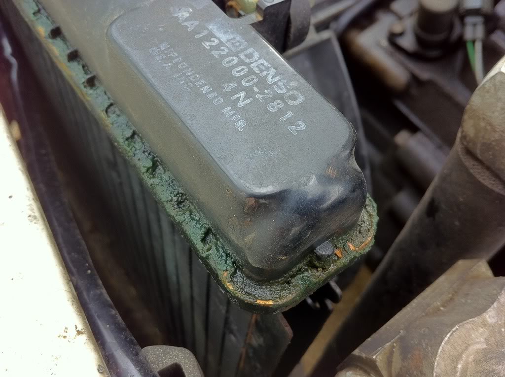

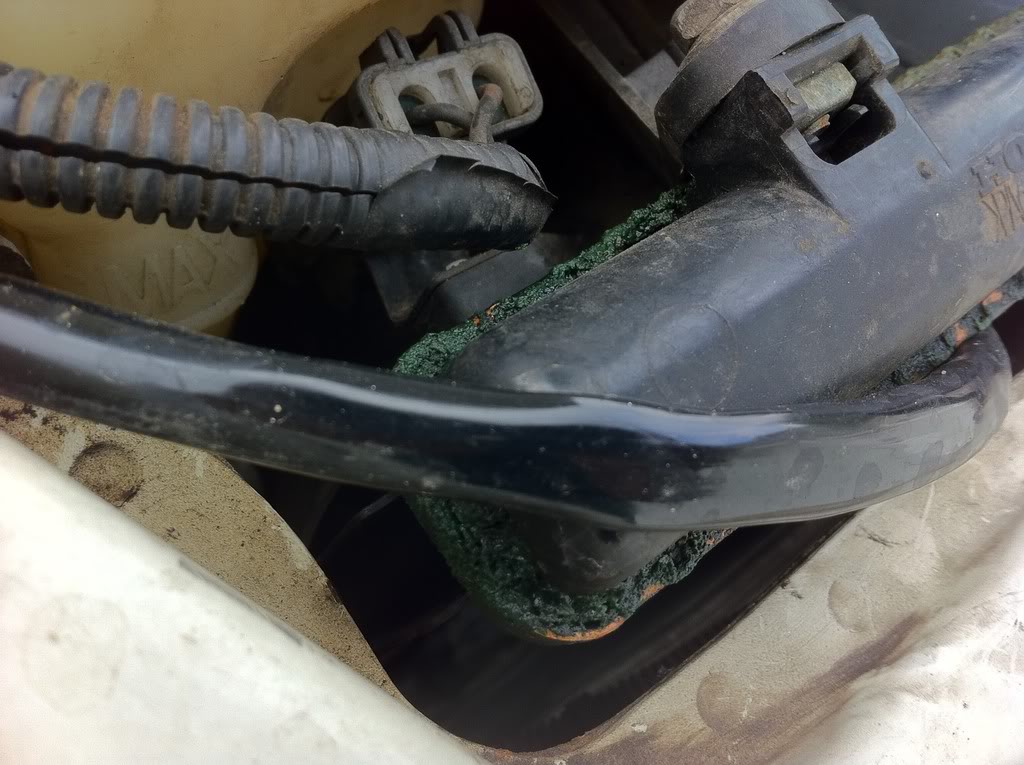

I found out today that i have a slow coolant leak. Its not as bad is it was a month ago when i replaced the radiator cap (was leakign about 4kish RPM) but in a month the coolant has gone from the max line to the min line. The engine doesnt smoke and other wise runs fine (i think, im not sure how the power is suppost to be, im new to hondas) I havnt done a compression test yet, picking up the gauge next payday... however, i have noticed this... sludge? around the top of the radiator:

considering they are fairly cheap and easy to replace i personally would just replace that old one haha then work from there
Old Apr 15, 2011 | 05:32 PM
Yes, that is a very minor and slow leak. I would replace it along with the hoses/tstat, too if they have yet to be touched in years.
