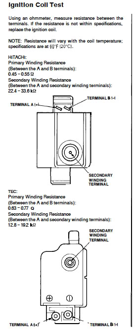

Old Mar 5, 2009 | 06:05 PM
I think it's more likely that you blew the coil in the distributor by cranking the engine with the cap off. To verify, check for the lack of spark.
If you have a multimeter, you can perform resistance tests on the coil or take it to AutoZone for testing.

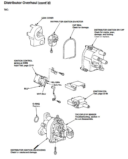

Thanks Ron, that would be a much simpler fix! I haven't ever had a Honda. I'm assuming the coil is inside the distributor under the cap that is below the rotor. Is that correct?
Old Mar 5, 2009 | 06:21 PM
Yeah, inside the distributor. This diagram may help:

Old Mar 5, 2009 | 06:27 PM
olcurt's Avatar
Joined: Mar 2009
Posts: 25
Ok, looks simple enough. I can find that. Thanks for your help!

Ron,
I found primary resistance to be 1.0 and the secondary to be 15.9
Although the primary is out of the range, is that a number that would be acceptable, given the meter could be off hat much?
Bob

Originally Posted by olcurt
Although my ohmeter is digital the lowest setting is 0-200 and when I connect the leads it doesn't zero out...it reads .2
Well, first off, I'd recommend that you purchase a new digital multimeter. I've seen them at Walmart and Sears, with prices ranging from $15 to $25. In my opinion, this is an excellent investment.
Also, any coil readings out of spec would indicate that it is bad.
