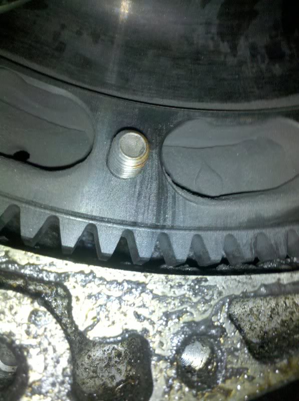

Ok, so my car recently started messing up. To explain it, When i go to accelerate my car Lags. I have a video to show what is happening. I think my clutch might have oil on it, but not positive.
Flywheel.
Sorry for not explaining alot, im not sure exactly how to say it.

either your clutch is worn out or there is oil on it, which is allowing it to slip. either way, the engine and trans have to be separated to fix the problem. good luck.
Old Jun 8, 2010 | 02:55 PM
Obviously replace the rear main seal while the tranny is out.
