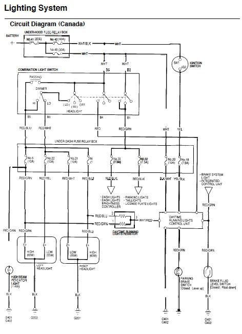

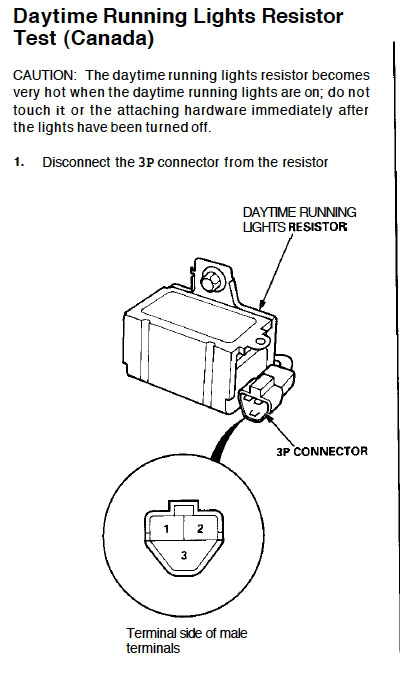

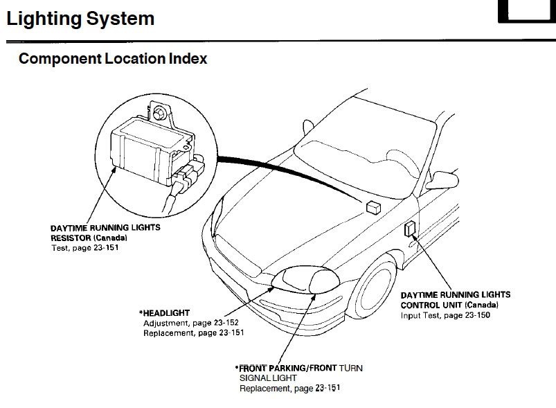

I am not absolutely sure about this but, based on the circuit diagram, I think you may have success by simply disconnecting the connector to the daytime running lights resistor (see diagrams below).

Or unplug the control unit, or take fuses 18 and/or 20 out (assuming they don't also power something else). It has been shown that it's considerably safer to have DRLs on. A couple of times I've had close calls because apparently the guy just didn't see me in broad daylight.

If this is done, the function of the brake fluid and parking brake lights will be lost, if I am reading the circuit diagram correctly.

Just pull the fuse. the DRL fuse doesn't power anything else

Trust me man, the fuse will not effect anything else, i pulled it in my hatch when i did my retro to prevent the HIDs from being on all the time.
