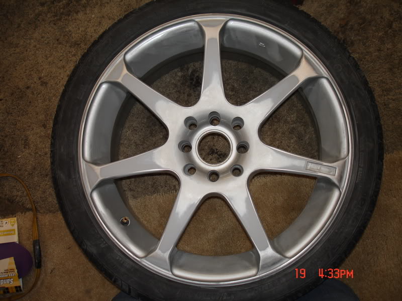

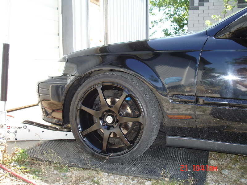

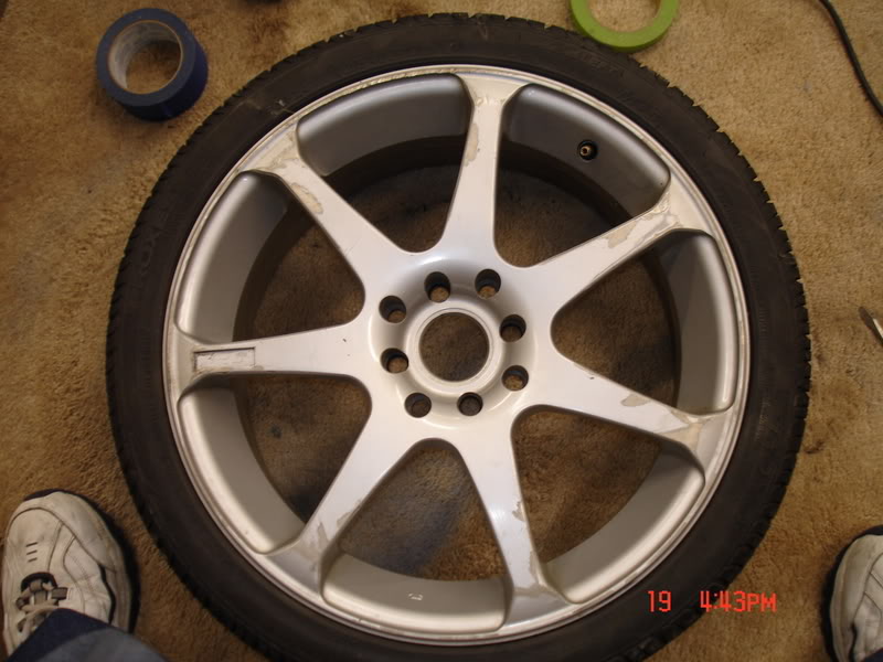

dito... depends on the wheels shape... i did my old wheels with my palm sander. worked great... tho they where mostly flat. but mine where so badly curbed all over i had to do ALOT of sanding, plus i was sanding out DEEP curb scratches...

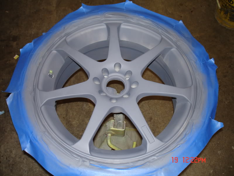

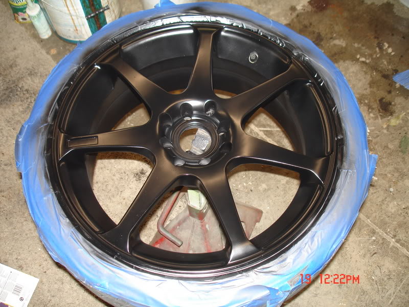

primed and then painted...

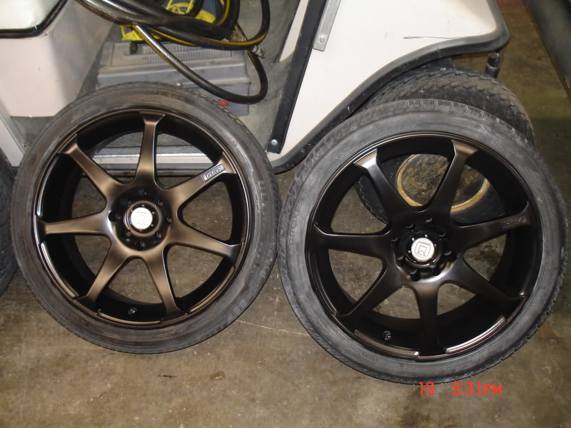

they looked great...
best part was i got those wheels/tires for only 75bucks cause no one else wanted them from all the curb damage on them... tho i couldnt fit them on my civic without them rubbing hardcore so i ended up just selling them for 250bucks. they cleaned up great! now they were not PERFECT but the one was badly damaged from the wreck.
i realy wish i just kept them cause that was the deal of a lifetime i think....

so just be sure if ya sand down to bare metal to primer them. otherwise the paint will chip off very easily....
