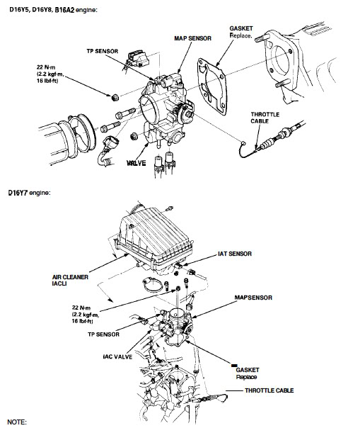

Default RE: Where is the IACV..
Old Mar 21, 2008 | 10:42 AM

Old Mar 21, 2008 | 12:09 PM
koots's Avatar
Posts: 643
From: Halifax, Nova Scotia
I thought with a Y8 automatic the IACV is on the throttle body like the Y7 engines. So look for it on the throttle body. It should be clunky and green, with 2 coolant hoses running to it and an electrical connector.

Old Mar 21, 2008 | 03:45 PM
Jgoad2's Avatar
Posts: 18
according to Ronj it should be on the bottom of the throttle body. there is 2 hoses going into whatever it is with a connector there, but it looks like it is held on by 4 small bolts.
