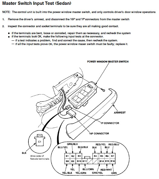

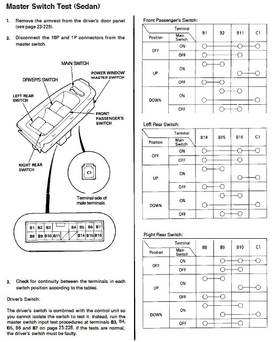

To test the main switch and its BLK ground wire, removal of the door grip cover may be sufficient (picture 1). This should give you access to both master switch connectors.
You can check the main switch by performing the continuity tests shown in pictures 2 and 3. In picture 3, simply test whether wire-side female terminal C1 properly has continuity to ground.
