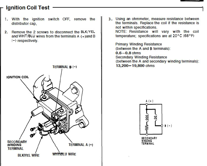

You had not previously mentioned the outcome of those two important tests.
Test the coil and igniter unit inside the distributor. An auto parts store will generally test the igniter unit for you. Also check for battery voltage to body ground on the Blk/Yel wire attached to the coil and igniter when the key is in ON(II).

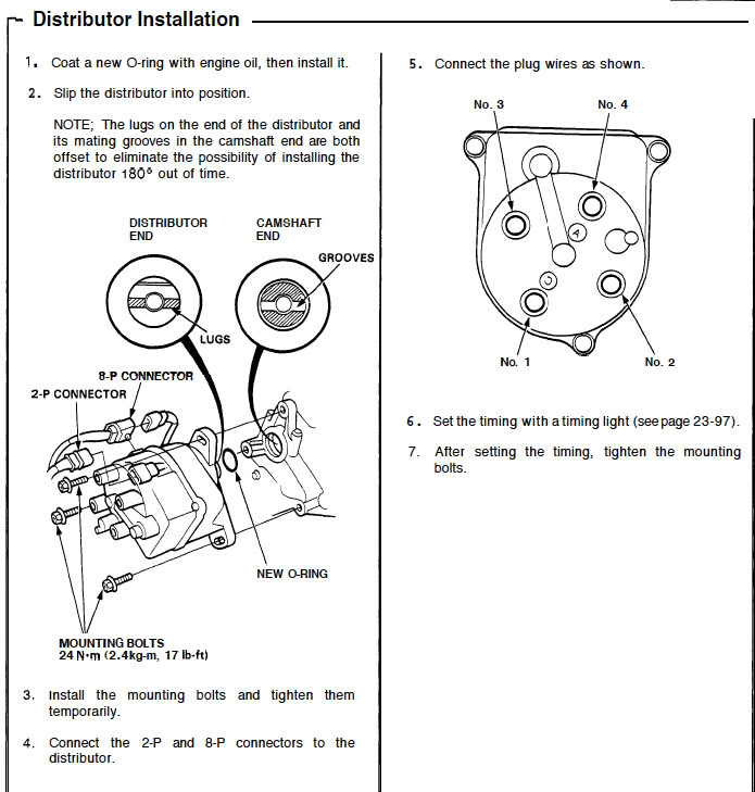

im gonna check the fire today do u have a diagram of the firing order i think its right but i could be wrong
Old Apr 10, 2010 | 07:51 AM
The cylinders are ordered 4-3-2-1 from the distributor to the timing belt:
