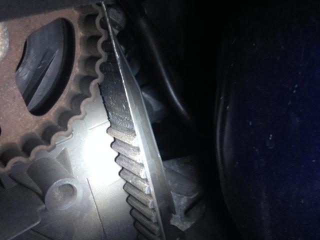

Old Oct 30, 2014 | 08:59 AM
No damage and the engine fired right up with a new belt. I was lucky. Your mechanic should be able to look at the belt/crank and see if it jumped teeth/out of time.
