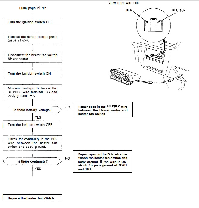

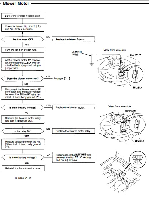

Here's how to figure out the problem:

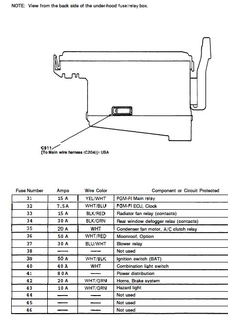

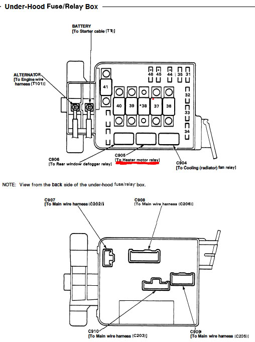

These diagrams may help:

thanks ron, perfect! the latest diagram you sent me is identical to what i have in my honda civic...now, thing is , i sort of tugged at that middle black relay (#37) but it doesn't come out...? how does that relay pop up??? do I use a screwdriver and pry it out? I didn't/don't want to break the thing, it just doesn't seem to want come up and out! does it just press in and out..or WHAT!!?? THANKS A LOT FOR YOUR REPLIES, i AM A LEARNING, AND I LOVE MY HONDA! ANDREW
Old Nov 19, 2008 | 01:20 PM
It is a fuse not a relay. Not sure, but there may be side tabs that must be depressed to remove it. I'll check a similar fuse in my fuse box.
