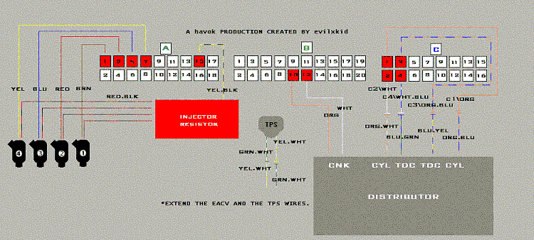

Hello welcome gald you joined.
i have also done this swap also very big difference in power dpfi sucks bad
My 91 hatch when i did the dpfi to mpfi
